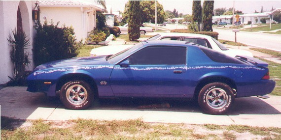

well i got it in.....it wasnt hard at all once you guys told me how to do it...lol
thanks again for all your help

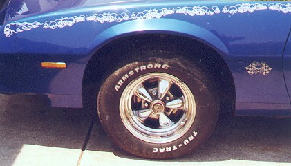

I had the motor rebuilt when I lived in Florida....which is where that pic was taken(the skulls are no longer on the car either) the motor came out of a 1986 van.... had 345000 miles on it.....so i had a guy i know who owns a machine shop(hes the local guy that everyone reccomends) work the motor and another friend of mine owns a shop so it worked out nicely......
sorry though it wasnt done in nj so i cant help you with who to go to up here
cost of motor 100 bucks
motor work 600 bucks(knew the guy remember) (1100 retail)
intall 200 bucks(500 retail)
