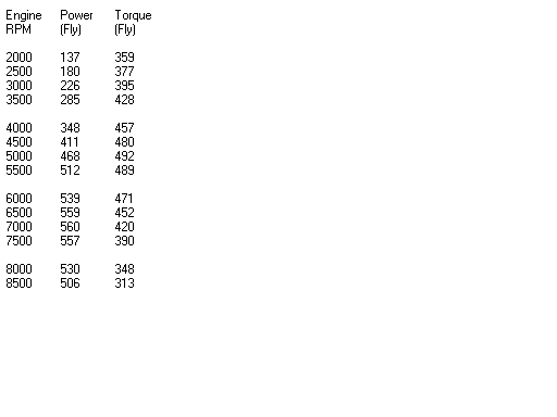

anyway I just got DD2k and ran a bunch of combos and I know that the program is supposed to be optimistic and it also does not account for driveability problems related to poor atomization and vacuum but see what you think:
4.125 dart block with 350 mains
3.335 bryant crank
6" carrilo rods
Flat top pistons (havent found - probably custom)
230CC Runner 64 cc chamber dart pro 1 heads
~10.92 Compr ratio with .042 gaskets and zero piston height
Comp 280 AR solid roller 280/280 at .55 lift and 110 LSA with 1.5 RR
I ran this combo with a tunnel ram type of manifold at 1000CFM and got over 350 ft/lbs at 2000 rpm (as good as the TPI I got now) and over 500 HP from 5500 to 7500 RPM.
I was thinking that the holley stealth ram might be a good approximation to this because I have read that the runners support 300CFM and I dont think I will need that much because I am not even hitting the dart heads opitmal flow lift at over .7"
because the valve lift is under .6 and the duration isnt crazy I think that this motor could work for a light street/road race car.
but what do I know....

One thing to remember is I think DD2k is off on tq figures. I seen an article in a magazine on this once.
Also another thing to remember is DD2k doesn't at all figure in cfm of a carb being too big. So in theory I could make a 305 with 1000cfm carb and it would work fine on the program... while that is way to much for a irl motor. They figure the carb you pick will run perfectly on that motor.
Also if you read the tutorial, like 136 pages long... not much of us have that much time... but anyways they say you don't make any difference in tq with longer rods such as 6.0 instead of 5.7 inch rod... just another thing
