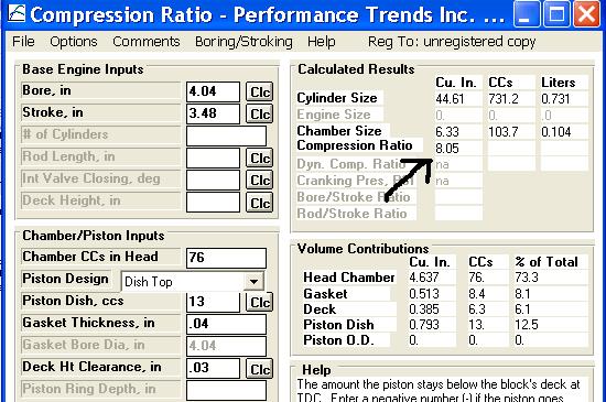

Mark A Shields: ok with some help from this site and my dad i think i have the numbers to figure it out.
head cumbustion chamber: 76cc
bore: 4.040"
stroke: 3.48"
gasket thickness: .040"
piston dish volume: 13cc
deck clearance @ TDC: .30"
head gasket volume: 9.1cc
Old Nov 12, 2002 | 07:09 PM
  #54
Mark A Shields's Avatar
Posts: 7,164
Car: 99 Formula
Axle/Gears: 342
bore: 4.040"
stroke: 3.48"
I assume you mean deck clearance of .030??
here's a screen shot for ya.
bore: 4.040"
stroke: 3.48"
Based on that I get 8.00:1
On that Program if yu just enter the gasket thickness
.040" the cr is overstated because the gasket is actually bigger than the bore size. 4.166 to 4.04
I enter .0425 instead of .040" to compensate
This represents the true gasket volime of 9.1cc's

ok based on that, i think my compression is somewhere between 8 and 8.5:1, prolly closer to 8 i think. so i think a set of 58cc heads will get me up closer to 9.5:1 i think, should give some performance. so do you guys thnk im right??
