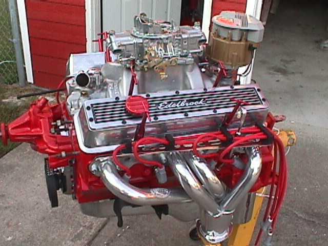

VIPER,
HERE IS MY OPINION:
This is what I did to my 283. Bored it .080, wanted to go .125(302), but machine shop did not want take the chance of going that far. Had some 461 camelheads laying around the garage and had them shrouted to 2.02/1.60 valves. Cam is (Crane-Blueracer) 230/230 @.50 480/480 lift. Put a Performer RPM and a 670 Holley Street Avenger. Also mine is a medium journal.
The trans is a 700R4 Probuilt w/A.C.T. 3000 stall. Hope to just have this engine in there until I finish my 406. Could be a setback with Iraq situation being im in the Army and getting deployed.
