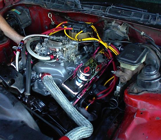

Here's my firewall, I have a custom made box to put in too so I can have my heat work, just haven't installed it yet. Also, it's a bit more cleaned up now, that was just a pic I snapped during some cleaning up.
Attached Thumbnails FIREWALL clutter! Can I eliminate this krap?-heaterbox-003.jpg

Here's another pic, may not be that helpful though. You can see how I cut the whole thing in half.
Attached Thumbnails FIREWALL clutter! Can I eliminate this krap?-camswapdoneengine.jpg

I don't mind cutting and mending if my heater will still work and it will let me eliminate that mess and free up some space. Is there anything else I will have to do to make it work other than just surgically seperating the two? BTW nice motor!

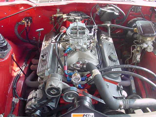

I just made simple duct work to keep my heat after I ripped out the A/C box. This is the old motor set-up and trying to see the ducting is rather difficult because of the angle, but it might relay the idea.
Attached Thumbnails FIREWALL clutter! Can I eliminate this krap?-bird-003.jpg

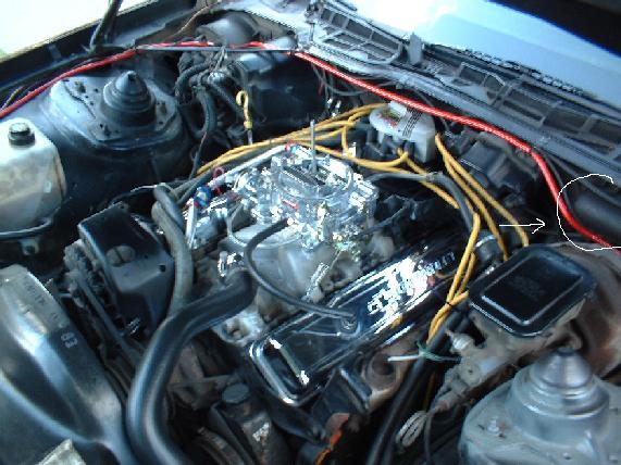

I took all the stuff off the pass. side. I then added a remote starter silenoid to make it look a little less off balance compared to the drivers side.
Attached Thumbnails FIREWALL clutter! Can I eliminate this krap?-new-engine3.jpg

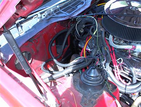

hey how did u get rid of all the stuff well almost all the stuff on ur firewall? johnsjj2
Attached Thumbnails FIREWALL clutter! Can I eliminate this krap?-car10-123.jpg

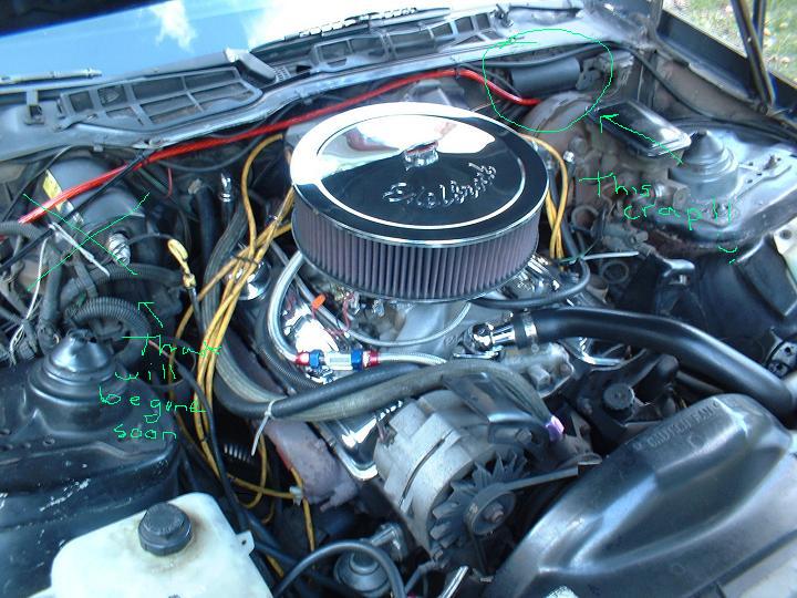

heres a better shot of what i mean of that thing i circled in the top picture.
Attached Thumbnails FIREWALL clutter! Can I eliminate this krap?-car10-732.jpg

That krap on tha passenger side is what I want to eliminate myself but I think it will have to wait until spring or something. I don't want to go a day without heat.lol

That tube in the picture is the vacum reservior Like I am sure it worked once upon a time. I took it off.
The vacuum is to work the heater flaps, so I just connected teh pipe to one of the dozens of vacuum connection holes they put in the manifold and it is fine.
That is one sweet looking engine. :hail:
One thing I couldn't see was the thermostat bypass. Normally the heater acts as the bypass, and you need that while heating up. If you don't have the heater, just drill bypass holes in the thermostat. You got to have a bypass to stop localized overheating on warm up.

im also talkin about that thing on the driver side by the brake booster. the thing that looks to serve no perpouse being there at all.

The tube near the brake booster is for sure as I can be the vacuum reservoir for the heater servos which are inside the car. Other years might have them located elsewhere and be different shapes.
They have a non return valve so that they don't adversely affect the engine vacuum.
I dumped mine and the heater still works OK.
All the stuff on the passenger side is for the heater and A/C. you want to make sure no air from the engine bay gets through the holes left when you remove the fan. At best it would be smelly and hot, at worst you can get carbon monoxide poisoning.
Is the car for competition, because there is a ton of heater stuff under the dash which could come out.
