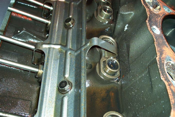

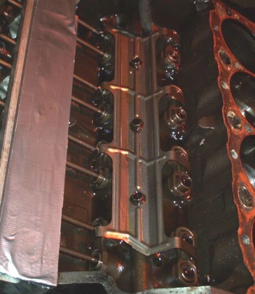

I don't know about the aftermarket setup, but the factory setup requires a few other pieces. 1 is a piece that goes over both lifters for a cylinder that uses the flats on the lifters to keep them straight, 2. is a big "spider" device that hold the previously mentioned pieces down. It goes to all 8 of them.
Any way you go, I'm sure you're gonna need shorter pushrods. I got all my lifters and holders used from a vortec truck engine, and I got a set of pushrods from www.sdpc2000.com as take-off pieces.

You can run the same roller setup that all the rest of us had been running for decades before the factory came up with that bizarre stupidity in those pics... now referred to as a "retrofit" roller. No machine work whatsoever required to anything at all. Bolt-in. Not cheap, but a direct bolt-in to an early block.

No, you cannot use a flat-tappet cam with roller tappets. Flat-tappet lifters aren't "flat", they're actually slightly convex; and the cam has a slight angle ground on the lobe, that causes the lifter & cam to touch only at the front (of the engine) part of the lobe, and the outer edge of the lifter. If you put a roller lifter on that, it will only touch the cam at the very front edge, and will immediately destroy both the cam and the lifter.
The original, common-sense design for roller lifters uses link bars to keep the lifters from spinning and a thrust button in the front of the cam to keep it from walking out the front (the inclined surface of a flat-tappet cam accomplishes that, so no retention is necessary with one of those). But that was too simple for the factory I guess, so they invented all that other stupid crap that forced them to change the block casting and everything else. Talk about shooting themselves in the shorts, especially on the cost side. Their nightmare Rube Goldberg uses that piece of sheet metal and those little ring things and specially cast blocks, and the nose of the cam is different, and the place on the block where the timing gear sits against it is different.
So, if you have a factory roller block, it's probably cheaper to get all that goofy stuff off of a junk motor. Roller lifters don't go bad much, and are usually re-usable. If your block is of the original design, then you can't use any of that, and you'll need to get the "retrofit" style of stuff, which is hard to find just laying around used.
