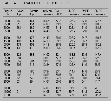

Heres an image of the DD2000 comparison. No power is gained until 6000 rpm. And i don't want to rev a 3.75" stroke motor up that high. I have the ProTopline 200 cc heads that flow really nice.
forget something, lol.
anways, what's wrong with revvin to only 6k, I don't see how the stroke has too much to do with it... I would think the condition and quality of the bottom end is a little more important.

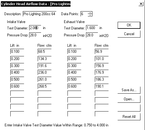

There's why increasing the valve lift by way of rocker ratio didn't increase the HP.
Torque = number of fuel molecules burned per engine revolution. HP = torque per time; i.e. how fast does teh engine produce this torque, or at what RPM does the torque exist. Therefore, HP = flow, i.e. number of gasoline molecules per time, which of course requires air molecules per th esame unit time, which is another way of saying "flow", as in cubic feet (of air molecules) per minute.
You engine is a pump. Think of all the pieces of the induction system as neing like a string of sections of garden hose. OK, you got your carb... it's 50' of 3/8" hose. You got your intake... 25' of ½" hose. Then the valves..... 10' of ¾" hose. Then the heads... 10' more of ¾" hose. Then the exhaust.... 50' of ½" hose.
OK, now you take the valves, and you up the size to 1". What just happened to the overall flow of the system?
Nothing.
That's what you're seeing by analyzing that combo with DD2k.
Now take those same heads, put a Super Victor intake on it, a 850 CFM carb, and 1-7/8" headers, and run it again. You should see a bit more difference. Because when you do that, all of a sudden the limit to the engine's flow is the valve lift!!!! As long as something else is limiting the flow, it doesn't matter how big you make the other parts, the limiting thing is still going to be the one that governs flow, and therefore HP.

Pro 200 with 2.08" valves. And a comp roller XR274-12 cam
What stock cam are you talking about?
Can you please explain why, in your opinion, his HP (flow) was not increased by the rocker ratio (lift) change?
Those simulator programs aren't my favorite way of doing business either; for that matter, neither is spending cubic giga$$$ at some shop: I build my own. But the simulators, while their absolute numbers are sometimes ludicrous, can point out in a big hurry where an engine can be improved, and where it can't. In this case, it clearly show that he's maxed out his flow in the heads and valves (since the flow didn't go up by enlarging those), and the logical person would therefore conclude that the engine's bottleneck must lie elsewhere.

Here is the flowdata:
All i'm asking how much power is usually found using 1.6 rockers over 1.5's? Is it worth stressing the valvetrain? What about valve to piston problems?

ME:
The reason they don't increase your HP, is because in the configuration listed in your sig (which I assume is what you're plugging into the simulator) the valve lift isn't the limit to the engine's flow. It doesn't matter how low the restriction in that place is, other restrictions are determining how many air molecules can squeeze through that motor. Look at the pump & hose analogy, that's the simplest way I know to compare how your engine behaves to something you can easily watch in action. HP is directly proportional to total engine flow, period. If you max out one portion of it to where some other part is flowing at its absolute *****-to-the-wall capacity, then further increases in that already maxed-out part won't increase the total flow.
Go ahead and do the DD simulation on a combo using the same heads and cam, but all the surrounding parts larger, and examine the change the rockers produce; I'd bet that it will be almost exactly a 6.666% increase (1.6 divided by 1.5). Direct, linear, one-to-one relationship of port size (valve lift) to flow; because the other parts of the engine won't be preventing further flow from occurring.
Or, like you say, why increase the stress on the valve train if it produces no improvement in performance. But, one could also ask, why put 400-sized heads on a motor when you're going to leave a 305-sized carb and exhaust on it. Match your components better: either reduce the heads to something within the same realm as the rest of the engine, or bring the rest of the engine up into the same league as the heads.
Rocker ratio increases absolutely will increase engine HP, if and only if the rest of the induction and exhaust components of the engine support that increased flow. They absolutely will not increase flow if something else in teh engine is limiting the flow. And if they don't increase the flow, then they're the wrong place to spend moeny; you need to be spending it where it does increase flow.

what i got in dd2000 with his setup

and what i got with his setup with an 850cfm carb like somebody suggested. which is a must. a 600cfm carb on a 383 is a joke. and defnitly the 1 5/8 headers are too small for this motor.
like they said. dd isnt exact. but the bigger carb made gains all thru. which is obvious it will especially on ur motor.
i didnt do it with the rockers simply because its a matter of what you have. kus an lt4 hotcam works well wit 1.6 rockers. but other cams may not. i guess it all boils down to what u have.
its like everyone says in every single thread. u gotta match parts. so i wouldnt be worrying at rockers right now. id be worrying about your carb and exhaust
