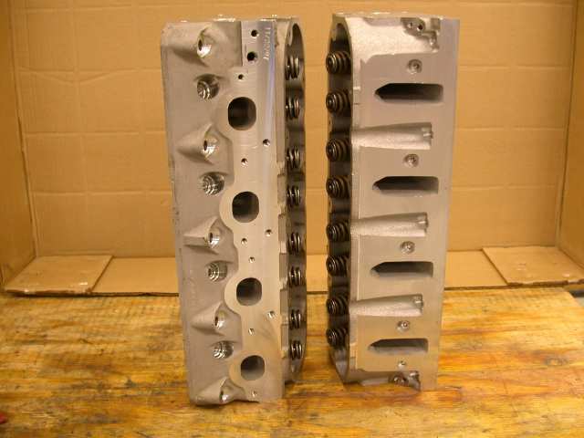

Let me post this picture of a LS1 head to finally put the LS1 intake question to rest. The head on the right shows the intake side, look at the ports they are huge and very tall! Not even close and the angle is way off to. SBC's use what, a 23° angle head? The LS1 head is 15°.

What the crap!!
Those are wild looking intake ports!!
What does that do to the flow characteristics? Higher velocity? Must be hard for the air on the long side radius of the intake port to make such a big turn into the cylinder.

Think so? Look at what LS1's run and tell me the air is having a hard time.

I wasn't denying that LS1's make power, but I was just asking what a port shaped like that does to flow. What are the benefits, why would the engineers pick a port like that? Again, not skeptical that it makes power, just wondering why.

john, thank you for posting that photo. i didn't know that the LS1 had the 18* valve angles. i wonder how much that improves the flow?

The valve angle is actually even less, 15 degrees....

Slepac is correct, the LS1 uses a 15° valve angle.
I will correct my first post now.
