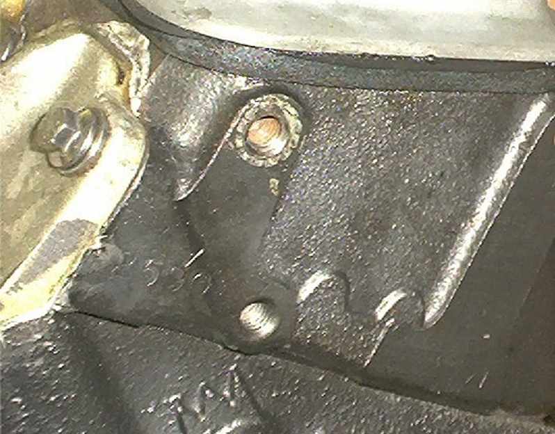

If they're really double-hump heads, they're 64cc nominal. Valve size doesn't matter.
350 motors that came from the factory with those heads had either flat-tops, for about 10.3:1 CR; or domed pisotns, for about 11.1:1.
Here's the casting mark:
Attached Thumbnails Need dishedpstons for camel  hump heads?-head-casting2.jpg
