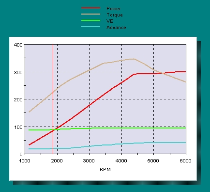

Here's a graph of what my program spit out.....
Old Jan 21, 2003 | 03:32 PM
1986_F-Bird's Avatar
Joined: Dec 2002
Posts: 23
From: Billings, MT
Uhhh....ok, here it is
Seems kinda weak on the bottom end for this cam....so I wanna see what you guys are getting and compare the two. I'm not so sure this program is too accurate.

Looks to me like too much intake....
You're set up to shift at over 6000 RPM, not too wise unless this is a heavily beefed up bottom end.
A more moderate intake such as a Perf RPM will give it back some low end.

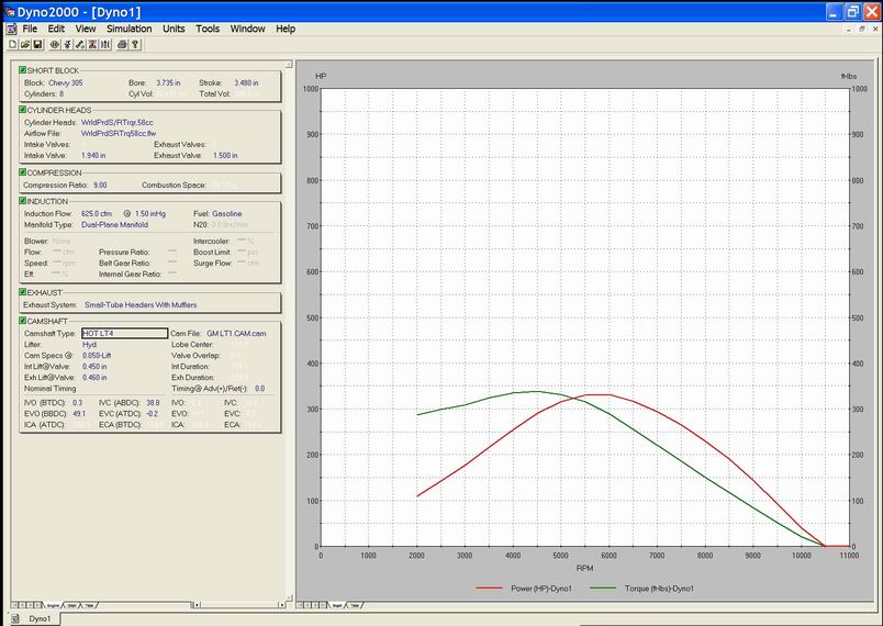

Hmm, I don't have a ZZ4 cam file so I used the LT1 cam.

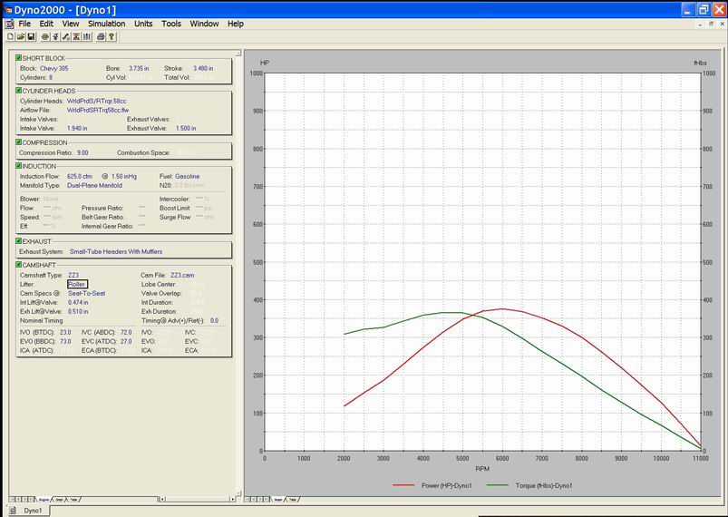

Here it is a with a ZZ3 cam file that I have. Yikes!

Gingo's...this really shows the difference between Carb vs TPI...same motor other than .030 over and 625cfm carb...wonder what the XE262 would come up at with your combo??

WOW!!! Just goes to show you that there can be differences in dyno programs. My actual bore size is 3.766" and I'm running 9.25:1 compression should be good for a little more power
Should be a nice torquey 305!!
