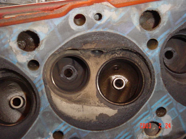

Here's a pic of the chambers w/o valves. Note the lack of any material below the seats. The port is wet because the valve seals just weren't doing the job (I think Perfect Circle Teflon are on the horizon).

Eeeew! Open chambers? Or am I just seeing the deposits and outline of the gasket print?

Never mind. Mr. Paint Shop and I cleaned up the photo a bit, and added some lighting. Your valve bowl diameters look good with those valve face sizes. I can see that the guides could use a little trimming, but other than that, nothing in the photo looks like a big impediment. There's probably a little room to raise the bowl and port roofs a bit, but it's hard to tell from one photo. Are your valves undercut?
Instead of three angle seats, you might want to ask your machinist about back-cutting the valve after the 45° grind angle and a radius on the front face/margin area of the valve for a little more flow. You're not shrouding too badly on either of the valves, but larger faces without some chamber trimming could put you into that zone.

Those are closed chambers. The gaskets were generic BBC, so they would fit 4.25" bore as well.
I just talked to the engine builder, he echoed what you said about porting from what I could tell him over the phone. The valves are stock (4 literally). I briefly mentioned 3-angle to him, I'll see what he says about your back-cutting suggestion. The Perfect Circle seals are a must. He said he'd check the springs to make sure they're really a problem (says he's seen great variance in factory spring quality/sources).

Took the heads to the builder Friday. He tanked them, checked for cracks, checked the guides, tested the springs, checked for flatness. He says, "Get new springs." Otherwise, everything looks good.
He also said to gasket match the intakes, remove casting flash/nubs, round off sharp edges, open up exhaust ports to the header gasket. He didn't think polishing was worth much, but didn't tell me not to do it.
Also said bigger valves won't help unless a much larger cam is installed, and even then the stock valves will be fine for a 396. Nor would reducing the guides help enough to make it worth the time. So, I'm about to get the die grinder out and get started. Then, he'll grind the valves (shouldn't take much), reassemble them with PC teflon/nitrile seals.
In the past, I had hesitated to talk to him about the engine, because he races a roots-huffed 383 in a '37 Chevy pickup. As I was loading the heads back into the trunk Friday, he said, "I always ran big blocks until I built the '37. The frame was too narrow for a Rat, so I started building small blocks." He started racing before ET meant anything...
