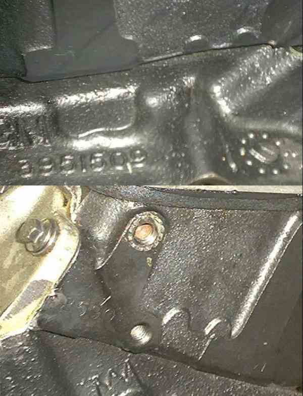

3.48" stroke, 4.000" bore, 349.85 cu in.... not too much else to say....
What do you want to know? Get a head casting number, that'll tell you if those are worth anything (they might be - some of those came with double-humps with bolt holes); other than that, there's absolutely nothing special, either good or bad, about it.
These heads came off a 69 or 70 350, maybe they'll be on that one.

If it's the double-humps (BTW those on that 400 block in that pic are 186 castings, off a 69 Impala) then you'll have the raw materials of a good motor. If they've been changed..... who knows.
Post the casting numbers as soon as you can.
