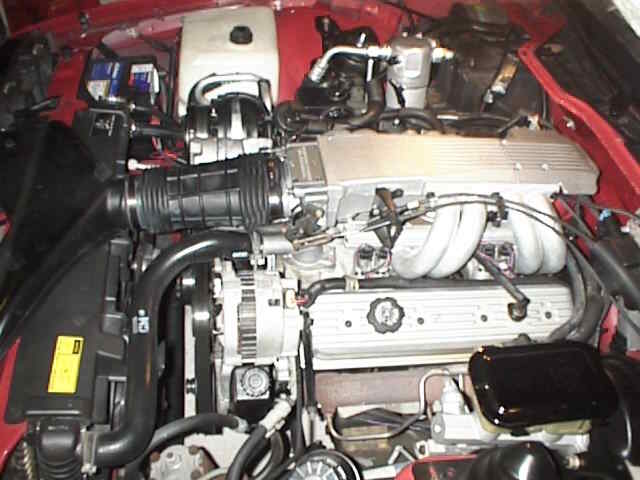

pop off the IAC and see if it is gummed up. carefully decarbon with carburetor cleaner. Reset it .. and cured the problem
Mine was doing the same thing after about 6 months of storage.
I replaced the fuel filter, stablized the fuel, new rotor, cap, plugs. I cracked the pickup in distr. so I replaced it and reset the timing.
I rented a vacuum guage, and vacuum was holding.
Runs extremely smooth now.
