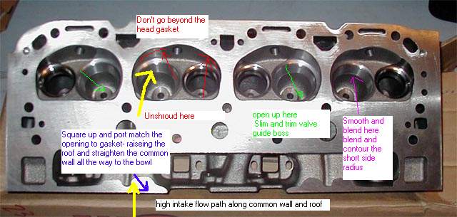

hey if your heads are in really good condition i say port and polish them and reuse them on the 350. that is with money being an option. you could always have bigger valves installed. just a though. and how much is that zz4 shortblock? you can get a 383 from JR Motorsports for a little over a grand. might be something to think about.

Your 305 S/r's will work fine on your new 350ZZ4.
If you're motivated you can home port them to good effect
your self The bowls need to be opened a blended and the guides nee to be streamlined. You can clean up the rest of the ports and port match the opening to your manifold.
Big enlarging of the port is not nessessary.
These heads respond nicely to porting.
