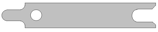

You should be able to find them at any place that sells starters. They look a little like this:
