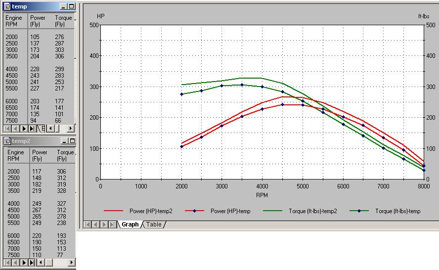

Originally posted by rustybluebird
i think he means
107 intake centerline,
117 exhuast centerline
which would work out to a lsa of 112 with 63 deg of overlap
using 287 and 287
Where's my sign???
Well let me redo the numbers then.
Here's a pick of the two.. one with High Performance exhaust manifolds, and one with "headers and mufflers".... I'd lean more toward the HP manifold numbers since DD2000 is known to be a little optimistic on torque numbers.
Old Apr 16, 2003 | 11:52 PM
2laneblacktop's Avatar
Posts: 115
From: Indiana
I think on most applications DD2000 over estimates. But those numbers look fairly reasonable at the flywheel. I would have guessed around 230- 240 at the flywheel, but heck thats just my opinion, and opinions are like aholes, everyone has one. But I think thats close.
