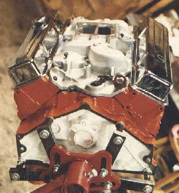

I have a 750lb capacity 4-caster engine stand with a 305 longblock on it using 3.5" grade 5 bolts and washers in the 4 outer/top bellhousing mount holes. Is it normal for the engine to be at a relatively "sagging" downward position? It just looks like it could fall off the stand at any moment.
Another strange thing is that when I pull the pin, I can't rotate the engine using the t-handle. Is this normal?
[This message has been edited by Scott C (edited July 25, 2000).]

went to couple hardware store, and seems no one carry grade 8 bolt. fyi the bolt size that will fit the bell housing is
3/8(diameter) 16(thread per inches) 3.5(length that suit your engine stand)
the block is on the stand and hopefully i did it right(i got some fender washer), it just worry me 4 little grade 5 bolt is holding the weight of the block. the block is sagging a little bit. (i think 3 inch bolt will be perfect) i can rotate it freely, i am ready to put the main bearing in and test fit the stroker crankshaft. to you engine guru this is nothing, but to me it is a giant step.
