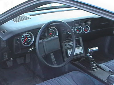

install took me probably 45 minutes, but do a search next time, theres lots of threads about this.
Old May 8, 2003 | 04:32 PM
aklaim's Avatar
Joined: Jul 2002
Posts: 318
From: San Jose, Ca
Did you convert to auto?!?!? I see a clutch pedal...

i don't wanna steal the thread... but camaro_1983_383 what guages are you running? how hard was the swap to put them in?
Old May 9, 2003 | 01:02 PM
camaro_1983_383's Avatar
Joined: Nov 2002
Posts: 250
yes, i did convert to auto. the gauges are auto-meter pro-comps. electric gauges. summit part numbers tach- atm-5160, speedo- atm-5154, water temp- atm-5437, oil pressure- atm-5427, fuel level- atm-5415. they are fairly easy to put in, but it was hard for me because i had to figure it out myself. i can give instructions to people though.
