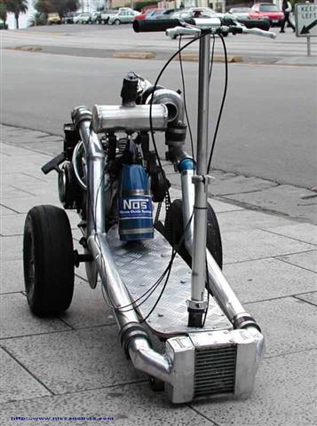

BTW, How do you like the turbo'ed, NOS'ed skateboard? lol.

That board is just sick... somebody has really "got it bad"
Old May 14, 2003 | 09:50 PM
Vader's Avatar
Posts: 19,677
Likes: 314
Is that an intercooler I see on the end of that board?
Hey! It's a technical question...
