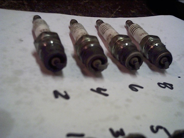

However, my plugs are looking like they ahve a slight gray or white color (all except #2). But, could this just have been caused by running hot for a while??
