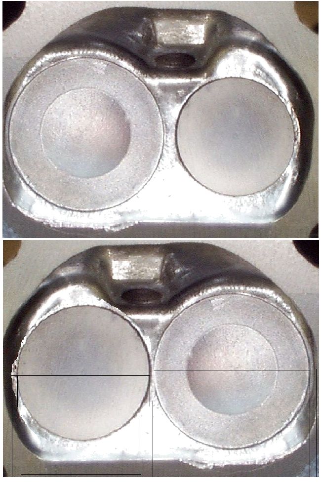

The extra few thousandths of bore can give you another edge as well. You may be able to go larger than the 1.84/1.50 valves since you can unshroud them a bit more on the outer edges.
Measure carefully at the bore and valve faces, and you can get away with 1.94/1.56 valves depending upon your head castings (14014416 can work). You'll still have shrouding at the outer edges, but the larger diameter could offset the difference. Of course, larger valves will need larger valve bowls, and straighter, larger ports to keep the cylinders satisfied. Of course, if you don't increase the valve size, you'll always wish you did. If you don't have the correct heads, plan on purchasing and reworking old heads or buying new performance heads, like World's S/R Torquer 305s for about $800.00 a pair.
