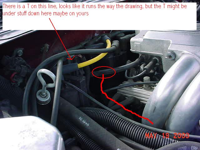

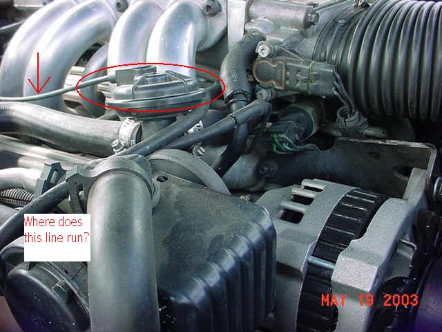

I checked the diagram, looked in yards, no tpi cars plus posted this in TPI, but no clear responses, so I thought I might try here...
Pics/diagrams/good explanation would be great
2 pics

and this one, the line is broken like 1inch away, cant see where it would go...
Thanks for all the help!

The small line on the last picture is a vacuum line that goes to your heater controls... and the thing it's running into is your heater diverter valve.

thanks man! any ideas as to the first one?

ok, I found one broken vac line in a loom by the firewall that has the coil wires in it, which one connects to that? And where would the other be? Please help, I would like to use my AC, vents not working!!

ok, the broken line I found doesnt seem to do anything when I hook up either lines. Which one is the hvac controls, and what does the other thing do? Main concern is getting the HVAC controls working any help? Begging over here...

I wonder if you would mind doing it in either hot pink or thicker lines please? I cant see it too good, but it looks like thats what I need to know! (heater valve) The cruise control on there, a T comes off the line and dont know where it goes, but if it isnt whats stopping my heater im not too concerned about it right now. Thanks soo much!:hail:

mine has a broken line coming off the T and has vacuum hissing when car is on... I hate my car,lol

what is the black thing on the bottom of the 2nd picture he posted? with the hoses going into it? Can i remove it? Is it something with the smog pump? I am doing a smog delete and i need to know what all i can get rid of. Thank you very much.
