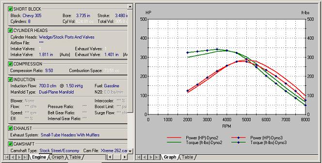

Here's a chart from DD2000. Try not to look at the actual numbers so much as the torque curves.
I used the two cams you gave the specs for. Notice how the peak HP and every RPM above peak HP of the 262 is only slightly higher than the 249 (the 249 is the dotted line), but the torque below that is higher with the 249. HP above peak isn't used very often so I think you'd be better off with the 249.
I think they want to make your car perform on the street well, and torque does that. Plus lack of torque is something the 305 suffers from anyway.

Wow! I wouldn't have thought that the smaller cam would have more under the curve like that. I assume that would help the vacuum also. I wonder how it sounds compared to the stocker that is in there now? How accurate is Desktop Dyno? That looks like a HUGE torque and horsepower increase over my stock 165 hp and 285ish torque.
Thanks for the Dyno chart! Thank you all for your help!

Hey AJ, how did you get the dyno 1 and dyno 2 to be on the same page? I have never done that with the DD 2000.
I just figured it out. I wish that I had known about this after several engines I have built. I always printed out the graphs and put the one on top of the other and held it up to a light.
