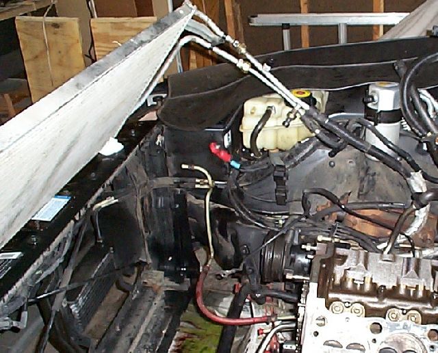

Ray is correct. The difficult part is getting the oil pan ledge-to-timing cover gasket to seal. There is a gasket available that allows you to cut/scrape away the original pan gasket, install the new segment, and dab the seams with RTV.
As for the AC condenser, it looks something like this:
