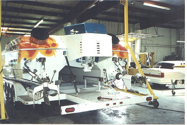

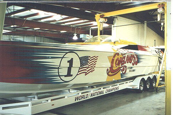

BTW - I stayed in your town once when visiting the Big Easy. The hotel was right across the street from a little garage that had some boats stored in it. Imagine my surprise when I saw this rolling out on that Sunday morning - I just had to walk over there to get photos:

Vader, yea, Al Copeland has some nice toys!(that was a very small portion of them)
You must have stayed at the Landmark Hotel, my house is less than 10 minutes from there
