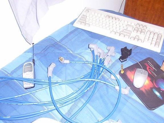

I got MSD Universal Plug Wires for $60 shipped (MSD-3110)...
I was assembling them, and I realized the electrode cap sticks out of the boot. All of them do.
They also are too loose to fit a spark plug, it just slides off.
I don't know what's going on, but I know they're crimped on the correct side.
What do i do?

some of the terminals have to be bent at 90* after yuo get them in the boot and the terminal crimped on. does your's need bent? what did the instructions say to do?

they ARE bent
I think I followed the instructions correctly.
there's really no other way it could be done.

Did you use the proper ends? Those look like they're for the straight boot type to me

they're the only ones it came with, and they have a bending point right after the crimp

Those ends are supposed to go INTO the cap. There are two styles of terminals. You have the wrong one.
Here's a pic to explain what I mean. I know it's odd, but true.

I honestly don't understand why (whoever) even sold you that kit, unless you didn't tell them what car/engine/ignition system you have.
AFFAIK, that style cap hasn't been used in a WHILE. I had one like that on my '65 Merc Comet.
I believe GM switched in 1975.
Here's a link to that style dist cap.
http://store.summitracing.com/partde...D120123&view=1
I don't believe you can get a cap like that to work with and HEI system. IIRC, They're different size caps.
Looks like you'll have to return them, if you still can. Otherwise you're out $60.

*** I AM AN IDIOT
SOCKET STYLE VS HEI STYLE
is there anything I can do? I'll return them like nothing ever happened and get the other ones indead... possible?
