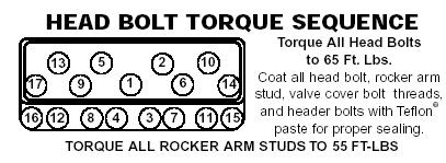

best final torque and sequence for head bolts with shim gasket

I think the standard is like 67 foot pounds, three steps. What do you guys reccomend for my setup now with shim gaskets

Hope This Helps..
Attached Thumbnails best final torque and sequence for head bolts with shim gasket-head.jpg

I always to mine in 4 steps. 34 times 4 torques each is 136 torques..lets just say that my arms are tired afterwards but it's worth it lol.
