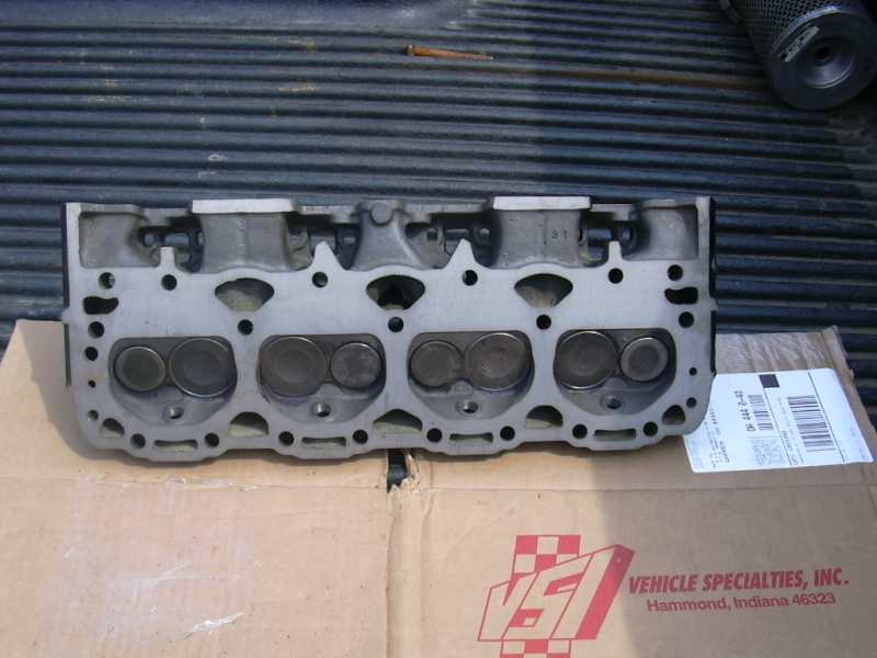

i paid $315 for my 416 castings that have the following....
1.94 intake/1.5 exhausts
screw-in studs
valve springs good to .530" lift
they need ported, but i want to have them flowed before i have the ported, to see how much the 1.94 upgrade helped.
i plan on putting these heads on a 350 eventually.
here's a pic fresh from the machine shop.
