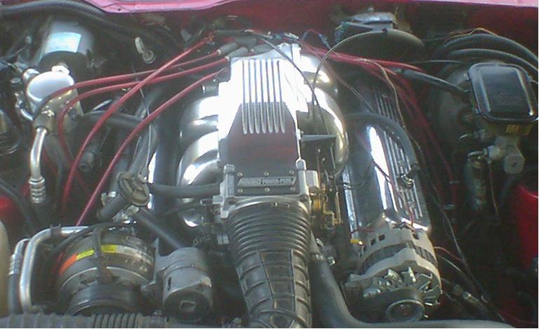

I'm looking for something new to do to my 1989 Firebird Formula 350 WS6. It has the following done:
1.6 Roller Rockers
Trick Flow Twisted Wedge G2 Heads
Ported Plenum
SLP Runners----not yet ported
stock mainfold base smoothed out and ported a little
Underdrive Pulleys
Adj Fuel Pressure Reg
MSD Ignition and wires
K & N Air Filter
58mm Throttle Body
Nitrous----150hp shot
Flow Master Muffler----80 series
What would be the next best bolt on? :lala:

lol.....yeah but i'm having trouble finding wire looms for my application. If i get the headers i have really nice billet wire looms. They just won't work with exhaust manifolds. Any other things todo?

I just used msd wire seperators and ran them similar to the setup in the picture.
Because of the tall covers? Or, because you've still got manifolds?
Straight boots would work with the manifolds. But, you'll be installing headers soon, anyway...

Do what I did with my wires. Works for me, and should work even better for you. Engine looks cleaner too. Route all your wires on the right side of the distributor for the side of the engine (2,4,6,8 on the passenger, 1,3,5,7 on the drivers) and then route them down behind the engine (like behind the valve covers) and then around the manifold collectors. It works best if you have the wire clips that hold all 4 wires and a few zip ties as well. On the driver's side, just zip tie on wire loosely to the lines coming off the brake booster, and then put the 4-wire clip right under it. That way, all 4 are held away from the manifold. Then just do something similar for the passenger side as well. Also, if your wires are angle boots, turn them so the boots point straight down if possible.
I did mine like this, and it looks really clean and they are out of the way.
