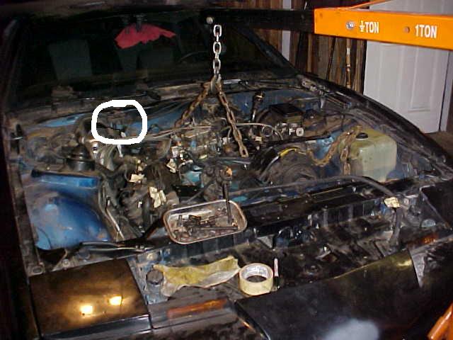

From: So Cal
sorry for the bad pick , but the baro sensor is the sensor located in this location(circled in white) if you dont know what it stands for it is the barometer sensor and it tells the car the atmosphereic pressure so the fuel curve can be adjusted accordingly.

From: So Cal
i think, and am definently not for sure, that there is a vaccum line going to the sensor. make sure it didnt get dicontected. make sure the harness is snug on it.
