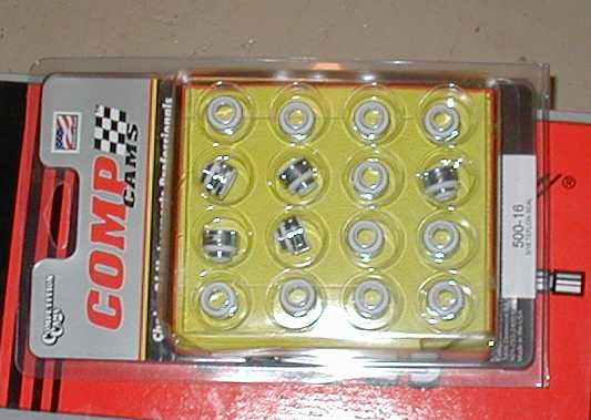

don't smoke when cold unlike Teflon seals
¿What?
This is something I've never had trouble with in all my days.... not once, out of a whole lot of motors. The Comp or Crane Teflon ones are all I'll even use.
And even those are nowhere near $80. They're more like about $25. The FelPro ones are around $16 a set or less.

My experience w/ Teflon seals wasn't Crane or Comp, so I stand corrected. Should have said "...like some Teflon seals."
That said, my experience w/ the FelPro Vitons has been so good there hasn't been a compelling reason to experiment with Teflon seals.
