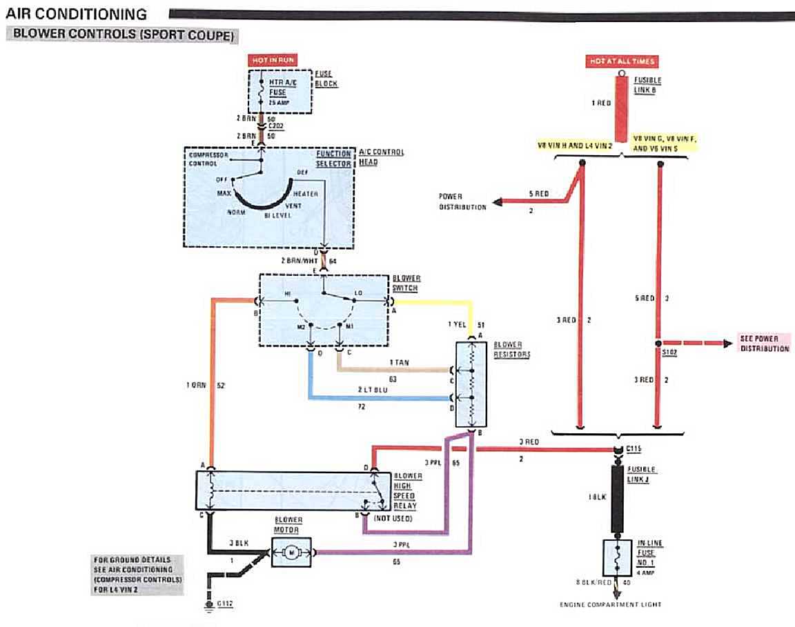

Since the blower doesn't even work on HIGH, you might be able to disregard the fuse. Check for power at teh fan relay and fan motor connector itself.
This might help, but you'll have to provide the voltmeter:

The blower won't work on High with a blown fuse either, because the power to operate the relay comes from the fuse.
Does the A/C compressor work?
If it also doesn't come on, and the A/C fuse is good, try taking the A/C control head out of the dash, and following the brown wire that comes from the "mode" switch, which is the one that's on the selector lever, and goes back into the dash. About a foot or so from the control head you will find a connector of extremely stupid design. If you attempt to unplug it, you will find that it's burnt to ashes. Cut both halves of it off, and replace it with a LARGE HEAVY-DUTY pair of slide terminals. Don't use the regular little weenie ones, because they'll just burn up too like the factory one did.
I've had to repair 4 cars just in my own family that deveoped this problem; my 83, one of my brothers' 84 Z28, another brother's 87 Monte Carlo SS, and my mother's Celebrity. I'd say it's a pretty common problem.

As usual, RB is correct. The blower gets its control power from the HTR/AC fuse as well:
