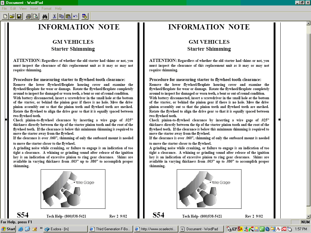

This involves more work but, remove the starter, wire it back up to the harness with it off the car (tie/hold the starter down) NOW try jumping the starter. If it spins then you had it too tight against the flywheel/flexplate and need to shim it for proper clearance.
I think the voltage to the starter is low. I'm no expert and diagnosing things via message boards leaves some info out but...
With really low voltage to the starter turning the key will do nothing. If the battery is low, all you get is a click.
I suspect the voltage at the starter isn't the full 12v.
try checking the big heavy cable that runs to the starter from the battery. Sometimes it is a replacement cable that has 2 bolts holding the cable to the metal part that attaches to the terminal. If this is the case, the end of the cable could be severly corroded.
If you suspect that the starter needs shims, you might want to just try adding shims rather than pull the starter all the way out.
Good Luck!
Good Luck!

So I think that the starter is too tight to the flywheel, causing it not to turn... and that I have a seperate ignition problem. I need to know how to test the neutral safety switch so that I can verify that it's not that. I'm fairly sure it's not the VATS, because I bypassed it (then unbypassed it after I found out thats not the problem),

Token Put the red lead of a volt meter on the small post(the one with some small wires attached) on the starter and touch the black lead to one fo the starter bolts. Have someone turn the key n let us know what happens.

What happens when you do this? I would hold off on shiming the starter, it may not need it. You may have screwed up the starter when you put it in, it is easy to twist off the internal wires that are connected to that little stud that has the small wires going to it. A full rotation of the the male threaded part and you will be SOL. All the starter needs is a little juice to the small terminal, a good ground and an *** load of amperage to the big terminal and it will spin. If all of these conditions are satisfied and the starter wont attempt to crank the flywheel then it is time for a new starter. "I just replaced it " is not the same as "It works" I would get the key working first.

I just dont want you to spend alot of time looking for a problem that is not there. Please make certin there is no power to the small stud when the key is turned, then at least you can eliminate 1 possiable problem. Also I dont know what to tell you if there is no juice when you turn the key, ignition swich? burnt wire? fuse? bad connection? you could spend days looking over all this crap.
