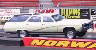

I have seen many stock spec Buick 350 yank both wheels off the ground easy. I have seen a few wagons do it too.
One fellow I chatted with for a while over at V8Buick.com
[good place to ask your question]
has a 68 sports wagon that did tow duty for 7 years before it ever got ran at the track and it got air under the front treads.
Matt
