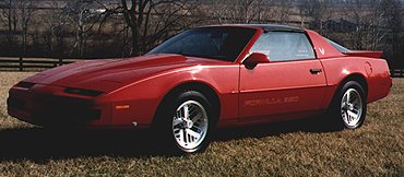

I have an 89' Firebird formula 350 WS6 and i'm doing a motor swap.......
The lower end is a 350 bored .040 over and decked the block .030 off. It has flat top fordged pistons and fordged rods with upgraded steel crankshaft. I have bought;
GM LT4 Hot Cam (roller, and i want to stay roller)
1.6 roller rockers
Trickflow Twisted Wedge G2 heads
Comp Cams springs (#926-16, support .600 lift)
Holley Stealth Ram
30lb injectors
58mm Tb
Stock 89' 350 Prom
Hooker SuperComp Headers and 3" mandelin bent y-pipe (i know the spelling is jacked...lol )
Its all supported with a Built up 700R4, stall (2400-2700), and the stock 3.27 posi rear-end
Wanting to know hp and tq estimates and peoples opinion on the setup......i still have time to change things up......let me know

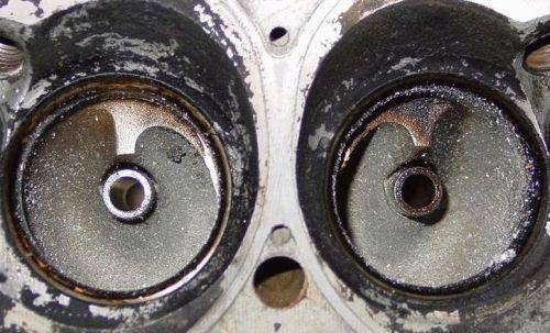

First off, what rockers are you using, or planning to use with those heads? You have to watch the piston to valve clearance especially with those heads, but I'm sure you already know that. I have a set of Pro Magnum RRs right now (1.52), but they are for standard chevy heads. Trickflow says I just need to buy the Pro Magnum Twisted Wedge intake rocker set because my Standard Pro Mangum exhaust rockers will fit. Also, my heads are the G1 heads. Did you look at the intake bowls of your G2s? I was just wondering if they looked like mine..............

lol......funny. I'm running the G2 heads, but i can't remember what the bowls look like. Sorry.
