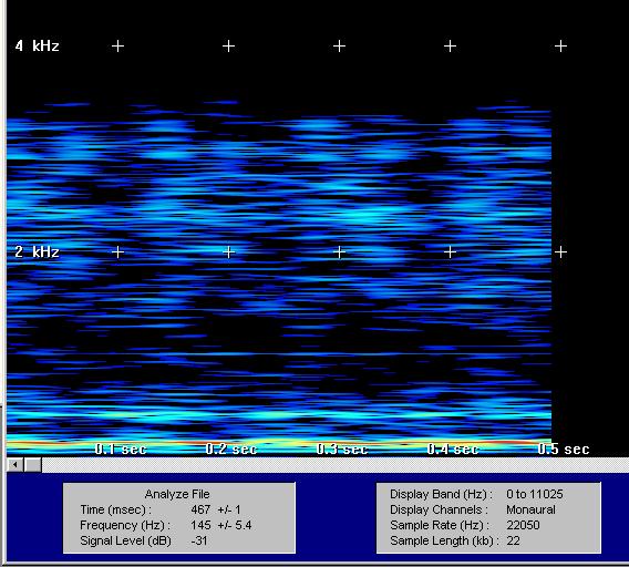

Last year I did some spectral analysis on another BB. A member was having rocker problems and posted the sound on the BB. I "dissected" the sound file and found this. The main sound energy is at about 140 Hertz. That correlates to every valve smacking at idle. The loud sounds are in red and the whispers are in blue.
I'm bringing this up because the engine sounded like it was a solid lifter engine, but was a hydraulic flavored one. The point is that most of the sound energy is at 140 Hz and knock sensors look for frequencies at the 4 to 6 kiloHz range.
And with this display I wonder if there is any sounds from a solid lifter engine in the knock detector range.
Caveat, the sound recording equipment sounds bandwidth limited, so frequencies in the 4-6 kHz range may have not been recorded.
***Sorry, I clipped the 4-6 kHz range, but there was NO sound energy there***

Here is the sound file
