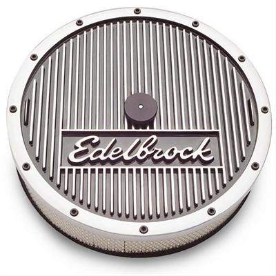

Well i recently obtained my car, an 82 z28 4 barrel, as everyone here knows the underhood is crowded.
So im thinking about aftermarket air cleaner assembly. Well what all is involved in going from the factory single snorkel assembly to something that looks good and frees up some room?
Can somebody gives me a run through on what all is involved and any pro's and cons, of going this way?
I like this look...its not too flashy, im thinking of going with the lid without the logo, for a more subtle look.
HELP ME GET THERE
HELP ME GET THERE

well i understand that there cant be too much to it BUT...
what happens to
A) the line that hooks to the bottom of the air cleaner from the carb
B)the thermac (?) fitting that goes from the snorkel?
C)the hose on the passenger side that goes into the air cleaner
D)...and the rest of that crap?
what happens to

A) goes to bottom of new air cleaner
B) if you mean that butterfly valve thingy, junk it.
C) junk it
D) such as?
theres a how to artical on the main page.. called TBI open element swap or somthing like that.
if you have a external coil HEI, you MAY have to move the coil, or bend the lower part of the cleaner to clear it.
if it touches the coil it will short it and possibly catch teh car on fire... be sure theres space...

ok if the "butterfly valve thingy" gets junked, what about the hole, where the flexible line from the bottom of it goes?
Is my coil the same coil that is in the top of my distributor cap?, does that mean its not external sinces its inside of the cover on top of the distro. cap? and i dont have to worry about the lid contacting it?
I also dont think my car has an IAT sensor connected to the air cleaner base, any input?
so i have to buy a breather...or have a tube just hanging around...any suggestions on choosing an aftermarket breather?
anything i missed?
anything i missed?

no.. the coil is in the cap... no worried with that setup.
if theres no sensor, then no worries... thats usually a FI thing anyway.
anything i missed?
anything i missed?
Joined: Apr 2000
Posts: 1,537
Likes: 323
From: South Windsor, CT
Car: '89 GTA
Engine: ZZ6TPI
Also, cap the vacuum port on base of the the carb. It's the vacuum line that goes from the carb to the stock air cleaner for the Thermac system.

well then, i think im going to go ahead and order this thing. Im going with the logo'd one, there other series are too much chrome for my taste, and when i get to valve covers, maybe i'll get them without the signature...thanks for the help.
can i buy a breather locally for inexpensive? are there different sizes? or should i just order it with my assembly?

you can get a cheapie one in the chrome stuff section in the local auto parts store.... you know the one where all the cheezy chrome "performance" parts are...

so if you look for a "regular" push on breather, it'll fit..... remember, its being pushed into a rubber grommet, so theres a good deal of play envolved...

ok so i got my air cleaner, but i havent put it in yet few more questions to reassure myself.
1) the little foam filter inside of the current air cleaner set up is the breather filter, and you follow the old hose to where the new breather goes right? the "push in" breather?
2) the really small hose that goes from the bottom of the carb is a vacuum line for the thermac? and it just gets capped off?
3) the stove pipe that connects to the bottom of the thermac and to the valve cover. does it get a capped off or do i need some kind of vent , or breather there too?
these are the only things attached to the air cleaner assembly right?
the tiny hose, im guessing the vacuum line.
the stove pipe, which goes from valve cover to thermac.
and the foam breather filter thing.
