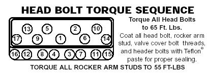

basically what i did when i swapped heads for the first time was i actually wrote down on paper the parts i removed in order, took my time and just checked stuff twice if i was unsure of something. keep all your tools and parts separated. it's not a hard job just involves taking a lot of stuff out. i took about 5 days to do it but like i said, i went slow, and everything turned out fine. also you'll need to adjust valve lash before putting on the valve covers.

just for me to get an idea in my head, take valve covers off, take intake off, leave exhaust manifolds and spark plugs in, take head bolts off, lift the heads up put the gaskets in and reseat head? is that the "taking a lot of stuff out" you were talking about?
