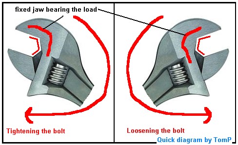

I've found sometimes that a LARGE (like, 15") open-ended adjustable wrench works great on flare nuts- even better than the properly sized flare nut wrench. (Aren't those tube nuts 12mm on the radiator? I forget.) Just make sure you use the open-ended wrench "correctly"- you want to put the largest jaw on the tube nut so it bears the most "grunt" against the nut.
And since that doesn't make sense, I happen to have a handy little picture drawn up. This method has saved me more than a few times breaking free rusty brake lines. (And like I said, yes, I had the proper sized flare nut wrench, and they're made by Craftsman- not as good as Snap-On, but a heck of a lot better than the dollar store stuff!)
