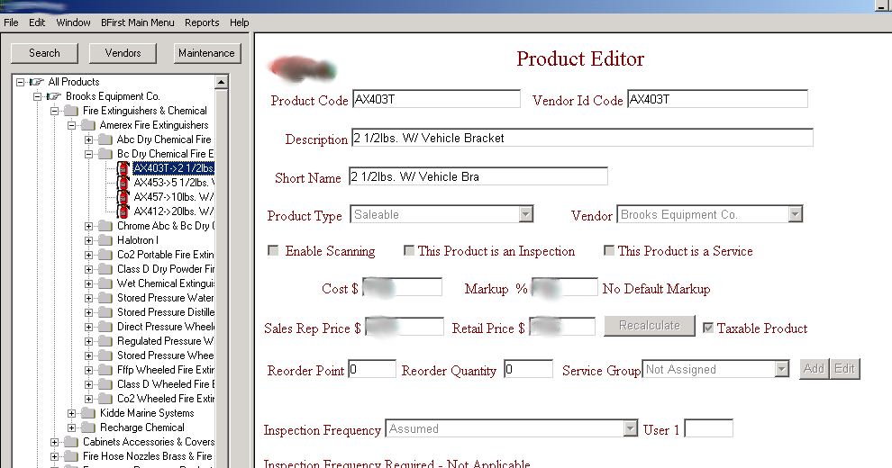

hehe, i cant show you everything, but heres a lil bit of somthing im workin on.... imagine doing your job with a hand held computer... printing out everything without writing anything, easy inventory, directons to locations with maps if needed, on site maps and checklists, ect.. all kinds of stuff.

They do that at my university! I keep trying to get that job. it must be the easiest day of work on earth.
Im sitting in the lab and this guy hits the extinguisher with a supermarket scanner and swaps out a sticker and almost leaves before I get to talk to him.
Wow.
