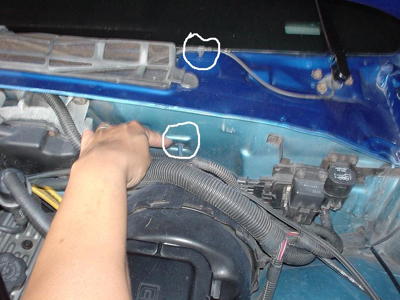

Ok Tom here you go. First, you run the hose from the washer fluid pump along the driver side fender lip area. Second pic shows where the hose enters the firewall, it's right behind the brake booster, Then comes out of the top area by the screen. I circled those points

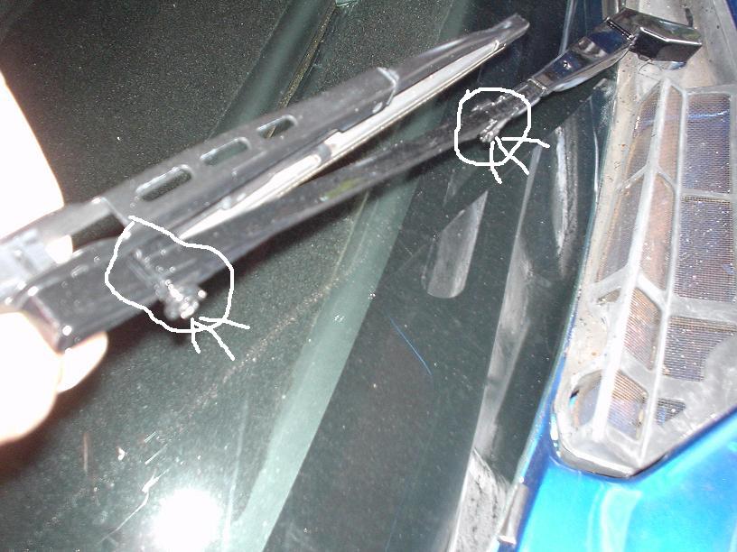

This pic shows where the squirters are on the wiper arm & which way they squirt. There are 2 of them & they clip onto the arm. I don't know the part #'s for them.

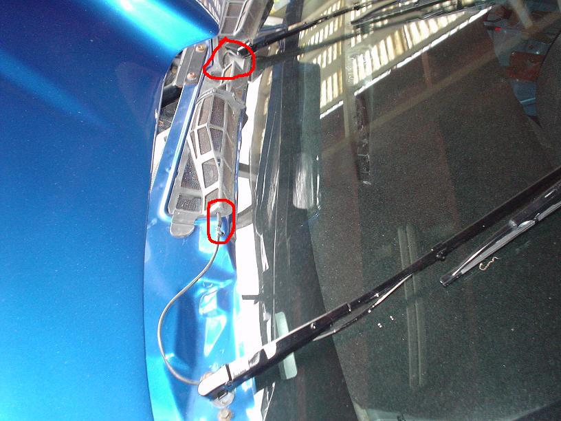

This pic shows how you feed both wipers with the hoses. You can see how it goes through the screen also.

Ok last pic. Sorry Moderators, I know I posted more than 3 pics, but last one I promise You can't really see it too good but the hose running on the wiper arm is smaller than the hosing before it gets there. Just use an inline tee to get to a smaller hose size. Also it snakes through the spring at the bottom of the arm. If you don't know what spring I'm talking about I circled it so just pull your arm up a little then you'll see what I'm talking about. PM me if you have any other questions. Hope this all helps & good luck on your little project
