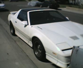

I'm having the exact same problem...
I just posted over in TPI section but I've been reading all night long it's 4 something in the morning right now but my car has the same symptoms but worse....I can barely get it moving cause if I push the gas the car hesitates or afterfires so I have to get the rpms up high enough by pushing and releasing the gas a bunch of times till it hits 3000 or so rpms and the just drop the clutch...if I keep it between 2700 and 3300 it runs fairly smoothly .... if I try to increase speed it stalls and hesitates and if I decrease speed ...rpms get to low same thing happens. I don't know if you've checked your codes but I've got 33,34 and 42 so hopefully someone will have a solution....

33 and 34 are MAF error codes. Make sure you have power to the MAF (both 12V and 5V), and that you are not getting power through the burn off circuit. 12V applied to the burn off curcuit during operation will render the MAF signal useless.

Thanks Vader...I just printed that out...I'll check it out and yak at y'all later...I'll try anything at this point.
