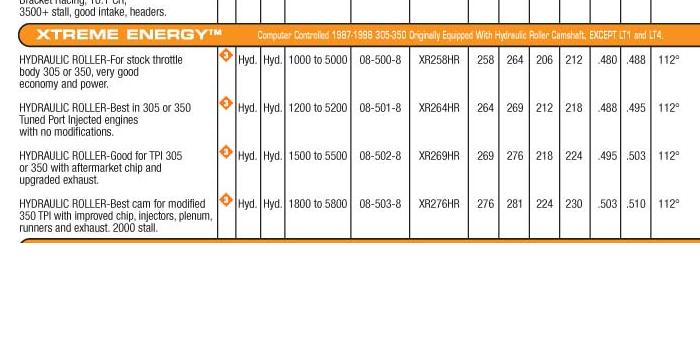

If you heads flow fairly well and you have ported your TPI intake (top to bottom) and you have headers, then I highly recommend the cam that I run (comp cams XR276HR-12) and the corresponding cam kit (springs, locks, retainers).
It's an AWESOME cam!
