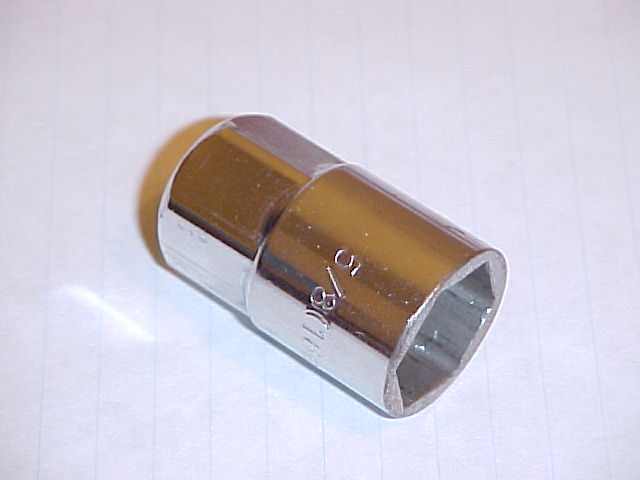

With the stock exhaust manifolds you should be able to get most of them from the top and rearward ones from underneith. When you go to headers it may be time to modify one of your sockets or buy one like I did from ebay. This tool makes things so much easier and I can install and or remove plugs in a few minutes.
