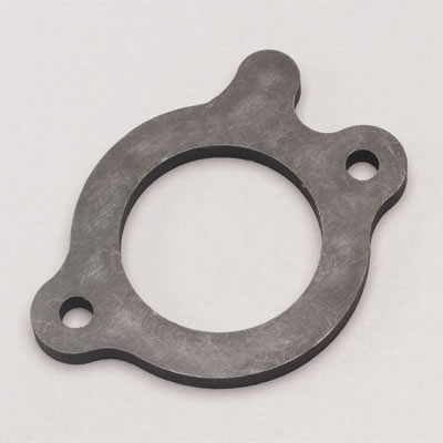

The thrust plate is a little plate that bolts between the timing gear and the cam. It bolts to the face of the block. It looks like this kind of (this is a Ford thrust plate)
The front of a stock roller cam or stock replacement is notched, like this:
The notched area slips into the center of the plate, in the big hole, and the plate prevents the cam from "Walking" forward in the block.

Ok I gotcha. Thats what I was thinking it was but I wasn't positive.
Why do roller cams need it but a non-roller cam doesn't?

The lobes on roller cams are ground flat, rather than a tappered profile that is found on the flat tappet cams. That contact between the lifter and the tappered lobe creates a force that pushes the cam towards the rear of the block. Because the roller lobes are flat in comparison, they are free to walk forward. Although, i think they have to overcome the force of the distributor drive still.
