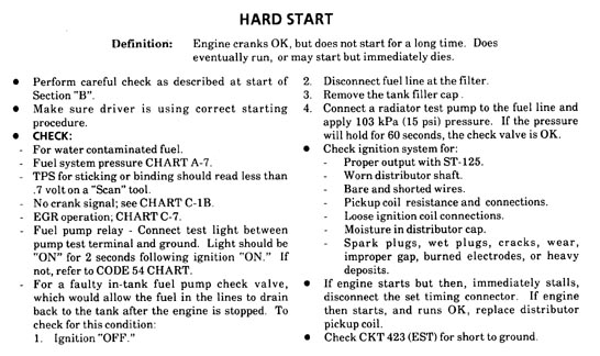

Here's a few items that you could check. Some of the items listed here you have already done.

Thanks trickster will use that list, to check the stuff out won't hear from me till Sunday , Unless i can get the 2 year to do the cranking of the engine for me.

Ok I decided to repull the chilton book out, and take another look at the wiring. Seems in my haste to put the relay in I swapped the one out for the blower I believe, anyhoo I swapped the relays with each other tried it out started up like a kitten. Next time I will take a better look at the color of the wires. Glad I didn't pull that tank , the floor is sure cold in wisconsin during winter.
