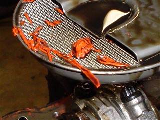

Take a look at this piston!
I picked up a 350 roller block out of a van recently. I'm gonna use it for my buildup instead of the other block I bought online a few months back thinking it was a roller block. Anyways, this engine looked like it had either detonation problems or debris fell in two cylinders. Not sure which of the two.

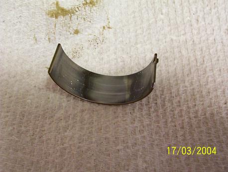

I pulled the oil pan off, and took the rod cap off on the piston in the second pic. This is the first time I take a look at engine bearings, so I don't know what to make of this. It has some marks that are discolored, and a couple of tiny spots that are shiny. It feels completely smooth though.

Sorry, heres the pic...

That's what pistons look like when debris or hardware falls down through the intake.
The bearings don't look all that bad.
At the very least, you'll need a rebuild kit with a new set of pistons. Possibly a rebore.
Check the oil pan and filter for metal particles. If there are none then that would mean that the damage was most likely limited to the top end.
But to play it safe, it's a good idea to check everything in the rebuild process. But that's what you should do anyhow.

Last piston I saw that looked like that came out of a motor that ran lean at the track due to tuning, broke off a piece of piston, ruined the #5 piston, and then jumped over to #7 and killed it as well. They were TRW forged ones too... He ran WAY lean!!!

If you're replacing bearings anyway, what counts is what the crank journals look like, not the old bearings. I'd mike out those cylinders too. Most wear occurs about 2" in the hole, so check the tolerance there. Doesn't hurt.

That piston wasn't damaged by detonation. That's from a foreign metal object running around in there. Detonation erodes the edge of the piston under the spark plug, it doesn't put nice cute metal stapmpings in the side opposite the plug and leave the rest of the piston top entirely alone. Notice how all of the damage is confined to the area where there's no combustion chamber. The loose object broke the spark plug off. The small amount of damage right under the plug is from when the foreign matter wandered over to that side and got stuck under the plug boss.
The bearing looks mostly OK, obviously a little stressed, maybe from being used as a stamping press; but nothing really disastrous.

That picture of the bearing looks exactly like the ones that came out of my L98. I thought they looked trashed, but my bro who is a mechanic says they looked alright, not good but alright. The main bearings looked near perfect. And the cylinder walls still had the cross hatches in the a 123,000 miles. Maybe the bearings says I ran the poop out of it?

Here is a picture of a main bearing out my 406 with about 12,000 miles on it. Im not sure what caused it other than i found my oil pump pickup clogged with gasket material, but still had good oil pressure.... and the bottom end was not balanced. I belive there was some kind of debris in there too not sure what. This was the only bearing in the whole motor that looked like this. both top and bottom bearings look the same.

here is my oil pump right after removing the oil pan, I used a little bit too much RTV on the oil pan gasket..... ill use it sparingly if at all next time around... i learned my lesson. New crankshaft and a full rebuild again.

Omg, how did I know the rtv in your pic would be orange? I'm betting you used that Ultra Copper high temp crap huh? I tried the same stuff on my first oil pan gasket years ago with the same results. My engine didn't blow, but I had pieces of it on the pump pickup too. That sealer is worthless. The best stuff I've found is "the right stuff" that comes in the can and is black. However, nowadays you just buy the one piece oil pan gasket which doesn't need any sealer at all, unless you want to put just a dab in the corners for extra insurance. I'll never use a four piece oil pan gasket again when the one piece gaskets are so easy to install without leaks.
Im certainly no engine guru, but maybe the problem was caused by either incorrect clearancing or an out of balance rotating assy? The pickup doesnt look clogged enough to cause much trouble.

yeah im pretty sure the pickup wasnt clogged either, i still had good oil pressure. The clearance was right i checked everything when it was put together, my guess is that i got some kind of debris in there, and i know the bottom end was not balanced, i had it balanced before i did grinding on the rods for cam clearance, and i also changed from an manual to automatic which means i had to swith from a flywheel to flexplate, and my 406 is externally balanced.

Here are my thoughts. The top pictures are not caused by detonation. That was an object ingested by the piston. Could have been caused by a broken valve spring. Something went back up into the intake from the really bad piston into the one that doesn't look so bad. It can happen.
305s always detonate under a heavy load when it is hot outside. Besides a minute amount of carbon my pistons looked brand new in mine when it got pulled apart at 150,000 miles so I don't think detonation caused that. I discredit the lean theory because you would have atleast 4 pistons. Those two pistons share a common intake runner so that why I think their was a foreign object ingested.
