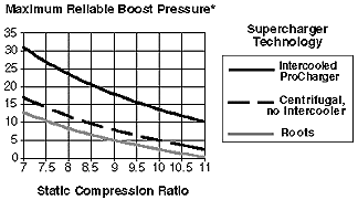

this should answer all your questions

Originally posted by flrtin1
This link has a table of Static vs. Effective Compression at different Compression and boost levels
http://www.holley.com/HiOctn/TechSer...fo/SCTech.html
the chart on that page is for non-intercooled superchargers... if you look at the picture i posted, and put it next to the chart on holley's site, you'll see that the effective cr matches the line for the for the roots-type blower cr
