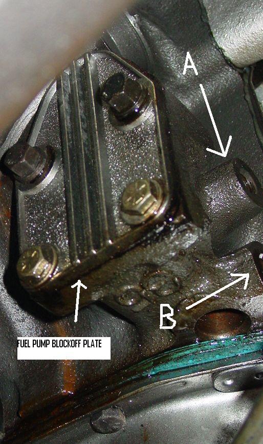

This hole that you guys mention on the passenger side of the block. Is it the upper one that is on the mechanical fuel pump housing? If so, looks like I've been running with it open for a year now.
A) Is this the one that should have a bolt in it?
B) This one doesn't go into the crankcase, I can see up in that one.

that the 1.. and I'd put money on it that that is why theres oil all over the front of the block there..

er yeah A to be more specific. oh and thats a snazzy blockoff plate mine have a bowtie on it

I saw the bowtie one after I built the engine. Wish I had it. Oh well, how many people see your block off plate anyway? That does seem odd that I haven't lost as much oil as one would think if it's open to the crankcase. Any votes for the Dex-cool leak? I'm pretty sure I know the answer to that one.
To-do list:
Feed dog
Feed self
Take nap
Plug open hole to crankcase
Thanks for the help. I've been trying to track down the oil leak since I built the thing. Rear main probably leaking too. *sigh* But I'll plug the easy one first.

89RS, tonight I looked at the old block I pulled out of my '86 and sure enough, it looks like that bolt hole takes a 90* turn down into the fuel pump housing (crankcase). So I put a bolt in my engine and I'll pray for a reduction in oil leakage. It never was really too bad (never had to add more than a quart), but I can't believe that I ran it that way for almost a year. When I built the new engine, I just didn't put the smog pump on and never thought twice about it. I'm glad I stumbled onto this post..... I wasn't searching for a solution, but happened upon it. Thanks.
