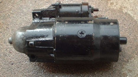

Can someone confirm if this is a high torque starter. I had read about a step but I wasn't sure if it was on the body (first picture) or the mounting to the block (second picture).

Looks like a regular starter. High torque starters usually have the motor where the solenoid usually goes. That allows them to use a gearset to increase torque.
